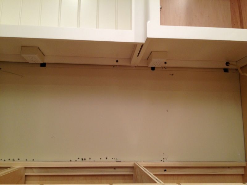

Hey All,
I asked for plug molding instead of having outlets throughout the backsplash. I know it's a preference thing but that's what I went with. We do have one double light switch but other than that no outlets or switches will be in the future backsplash.
Anyway, I showed a plug mold pic. Our electrician does many high end jobs and didn't hesitate.
Yesterday after they left I noticed they are outlets instead of plug mold. What do you think? I think I'm fine with it but am wondering if there is anything negative I'm missing. The light rail isn't on yet.

  • MizLizzie
    Hmm. I kind of like that. Might have turned it the other way, though, so the plugs ran across rather than toward you. It is going to set the cords so that they hang away from the wall a bit more than plug mold, if that matters. It will be interesting to hear what others say.

  • Fori
    Well it's probably almost as good but I hope you aren't charged for Plugmold.
    The angle on Plugmold should be much easier to use.
    I'd be irritated though, unless the sides are going to be trimmed out in nice molding or a bottom is added to the cabinet. Because to me that belongs in a wall or unfinished basement. It's unfinished looking. I know it will be MOSTLY hidden but not when you're plugging stuff in.
    Okay. I decided I don't like it and while maybe it's nicer than being in the backsplash, it looks like a cheap retrofit.
  • _sophiewheeler
    He did it that way because it's a lot easier and cheaper. Make him do what you asked for, and presumably paid for.

  • poohpup
    I'd want him to redo it. I agree with Hollysprings that he did it because it was easier for him. At the very minimum I'd want the outlet rotated so that cords would hang down close to the BS.
    Not a fan of plugmold, but, if I did have it, I'd want it installed at an angle like A2gemini. I think it would be a lot easier to use that way.

  • christine40
    I have those outlets also, my electrician said they do it instead of plug mold because then the UCL have to go at the front of the cabinet because the plug mold goes at the back (like A2's pic). My guy said for code reasons they don't do that (I don't know what code??) There are not supposed to be any exposed wires.
    I have those outlets and I like them....I have no problem with them, and with the light rail they are not noticeable. No worries 2 fishes!!

  • beaglesdoitbetter1
    I have outlets just like yours under my cabinets and plugmold under my island overhang running the entire length of the island. I don't have any issue with my outlets, you don't see them under at all and don't find the plugmold under the island noticeably easier to plug stuff into.

    Were it me, I'd see if I could get a $ credit since plugmold costs more than this solution. If they offer any kind of discount, I'd definitely keep them as they are--- as long as they won't show when your cabinets are finished.
    Actually, I think yours would probably be even easier to plug stuff into than mine are because the front outlet comes out further and you don't have to reach back as much.
    I do think the cord would hang closer to the wall if set horizontal instead of vertical. But, if you plug whatever appliance you are using into the plug closest to the wall, it is probably the same effect.

    One more thing- what does the plug mold measure height-wise? As you can see the boxes I have come down below the cab edge in the back a bit. I'm thinking plug mold might be less noticeable? Then again being the boxes are not all along the bottom, maybe what I have now is less obtrusive?
    I may leave them but am going to ask why I didn't get plug mold when that is what I requested and showed him a picture of...
    The LAST photo I posted is our baking area. The KA mixer is going to "live" in that right hand corner. The outlet is about a foot over which means when it's plugged in it will "drape" to the left. Maybe they can move it to the right-- but there's a wire coming out there that says UCL so I don't know.
  • GreenDesigns
    Either is acceptable from a functionality stand point. If you are OK with what you got instead of what you asked for, and there are enough boxes to satisfy code, then all is well.
    However, you will need a light rail molding whichever you choose. I'm surprised your KD designed the cabs without one. It hides whatever under cabinet lighting that you choose. You will notice that all of the kitchens shown in this thread except for Beagles have light rail molding. And Beagles kitchen has an extra high floor in the cabinet to create a much deeper "box" on the underside that hides the lights.
