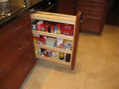

RE: Rev-A-Shelf Spice Racks for Fillers -- Have you seen these!!!
I have them on either side of my rangetop and love them! I highly recommend them if you need a 3" filler somewhere.
Open:
Closed:
They hold about 40-44 spice bottles apiece.
