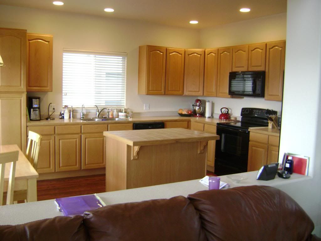

    I used a Minwax Mahogany gel stain. Here's a door to the laundry room cabinet that I am currently working on finished with that stain. The grain is still very visible and the color has been darkened from the original honey oak color. The key was to wipe off the stain after it had set on for about 15 minutes. I still need to do a couple of poly coats.
    Here's the original cabinet color in our before renovation picture.

    gpraceman, that door looks good, natural, like it's still wood. And it's not overly shiny. I suspect I'm dealing with veneers, since the back side of my drawer fronts do not look like oak. Wood, but something different so I doubt I'll get a similar effect as the front. The pieces of the drawers are all permanently attached to one another, so no way to just take the front off.
