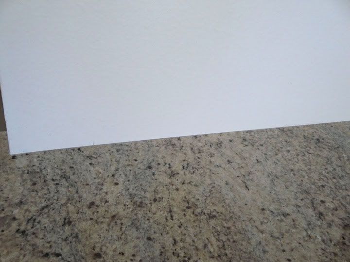

I need advice with an issue with our granite install. There is a 1/2" gap where the countertop meets the wall. The installers claimed they didn't notice it, but they had to have because they put the 4" backsplash piece right on top of it. They attempted to fix it by adding a patch and filler, but I'm not liking the look. I've researched online but can't find any example of this practice being done at all. I'm wondering if anyone can give me any insight on this or opinions. They still have to add a "darkener" to the seam and polish it more, but I'm not happy with it right now. Had they realized it when they put it in, they could've notched out the drywall and it wouldn't have been noticed. The worker admitted he got in a hurry while dealing with the seam at the sink and didn't realize it. They claim it will blend right in, but we just spent a lot of money on the granite to not be happy with something. Anyone have experience with this sort of thing?

    Oh my. There is no way they "didn't notice" this. And it looks like they messed up your wall when they tried to "fix" it. Looks to me like someone mismeasured. They really need to do it over :(

    The gap is a mistake and the "repair" is completely unacceptable IMHO. Properly done a small filler piece might have been acceptable but the repair pictured is horrible. When a mistake is made (which happens occasionally even in the best shops becasue people make mistakes) it is Ok for the fabricator to offer a repair if it can be done to the customers satisfaction.
    If there is a wave in the wall (which is quite common) a proper measure coupled with a professional installation would have eliminated that unsightly gap. Make them fix it.

    The attempted repair demonstrates just how little your "fabricator" knows about repairs.
    In this case, you have to make it worse to make it better in the sense that the radius must be removed, not filled with gray crap.
    Were I called to fix this, I would cut the radius off and make a nice butt seam. Polished and profiled, it should be inconspicuous.

    There's nothing wrong with a properly done "sliver repair" or chip repair. The issue is the horrendous workmanship on that sliver repair.
    2 of 3 of the below photos have a stone repair to them. Done properly. And it's NOT an issue. See if you can even see the repair. (Apologies for the poor photos.)
    IF they can't do a better repair with a better color blend, then it's do over time.

    Well, he came out and applied the darkener. Here is a side by side before and after:
    I really don't see what the point of adding it was because there isn't much if any difference at all!
    Here is another pic showing just how bad that corner was off by comparing it to the other side of the kitchen:

    Granite notched to accommodate old slide-in range.
  • PRO
    Joseph Corlett, LLC
    Granite un-notched for new slide in range.
  • PRO
    Joseph Corlett, LLC
  • hollr
    Wow, Trebruchet! That is an impressive repair. I am realizing now just what a crap job was done to our countertops. They will be resetting ours on Tuesday. My husband will be supervising. They'll remove that filler piece and refinish that corner. If that doesn't work, then I guess they'll just have to recut one of the pieces or both if need be. I sure don't trust them to attempt any sort of patch work at this point. They clearly are not are skilled as some installers. We shall see what happens next week.
