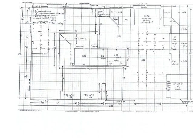

I think by turning the seating 90 degrees jakuvall may have meant something more like one of the below, rather than a peninsula. (Roughly modified from the plan on your other thread - you'd have to draw to scale to see if something like this would work.)

Here's mine: 134-135". It can be done, just not to "standard." That being said, we love it!
new plan #64!
