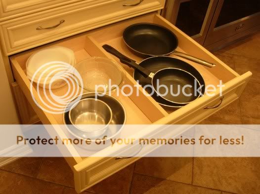

My U-shaped kitchen has three drawer stacks total so I went with two 4s and one 3. My cabs were custom and I measured everything. The drawer faces are 6.5, 6.5, 6.5, and 9.5. The 4-drawer stacks are on each side of the range. They're only 30 in. wide but they hold all my pots and pans, Tupperware, wraps, silverware, gadgets, glass baking pans, colanders, casserole dishes, and bowls. My 3-drawer stack is 18 in. wide and has a drawer for spices, bread and snacks, and small appliances. I use my over-the-fridge cabs for deeper baking pans like angel food cake and Bundt pans.

Ideas for Baking dishes in a drawer (not my drawers, I wish!) ...
