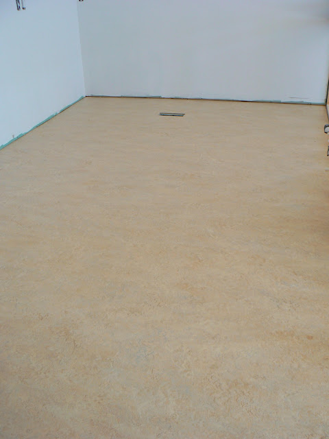

We did ours in Caribbean last year. We have two seams across the kitchen, but that was because we were also laying it in the adjoining hallways (and the closets), bathroom and laundry room. The hallway is one piece that has the seam under the door transistions. The same with the bath and the laundry room.
I can say that no one ever notices the seam till I point it out, and everyone thinks it looks good even with the seam. If you get a good person, they should be able to butt the seams so it will be almost seamless.
From Gardenweb photos
From 2011-07-19
