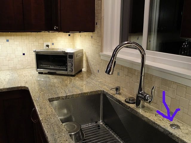

air switch:contractor says they jam
Marie Tulin
Do They? He says the two customers who have them say they jam. The wall switch you see below is 33 " from faucet, or two big steps for me. Can't be at faucet and reach switch

  • sjhockeyfan325
    I have had 3 of them (two in previous home, current apartment). None of them has ever jammed.

  • suzanne_sl
    I've had my insinkerator air switch for almost 2 years now. It's never jammed. I consider it one of my favorite things in my new kitchen!
    Question: how can it "jam"? All it is is a button that sends a puff of air to the disposal that turns it on and off. Does he mean the button itself turns sideways in its casing and sticks? I've never heard of that happening.

  • Circus Peanut
    To be fair, I did have an air switch that jammed. After pushing it in the button would get stuck in the depressed position, making it hard to turn the thing off again (with these switches, you push once to start, push again to stop). I always attributed this to the fact that I used a different brand of trim kit for mine, since the copper I wanted wasn't available in the Insinkerator switch I bought. You just had to fiddle with it a sec to get it to un-jam. Not ideal, but it's a rare enough occurrence (I think I'm the only one on GW who's had this happen to her) that you really needn't worry about it.
    It certainly wouldn't deter me from getting another air switch in the future. They're handy little devils.
  • heidihausfrau
    Mine jammed the first 2 or 3 times it was used. The contractor was here and we were both checking it out--it was new to him too! He thought it might be from dust when they drilled the hole. We kept playing with it until it stopped jamming. It has never jammed since.

  • pps7
    We have 2 air switches that we've used for 3 years and they have never jammed.

  • nightowlrn
    2 air switches in 2 different homes x 6 years. never a problem. i would demand on a future home. wet, messy fingers on a wall switch or opening a door under the sink and then on a switch = way to many things to clean IMO.

  • Cloud Swift
    We put ours near the faucet handle - even a little bit under it which makes it so easy to use because I often turn off the disposal and then the water. The old switch on the wall at our main sink was a pain to reach - I have a short reach and the window meant that it wasn't right over the sink making the reach even longer.
    At the island, we have the soap dispenser to the left of the faucet and the air switch to the right under the faucet handle - 3 holes tightly grouped on the inside middle corner of the prep sink which minimizes the disruption to the island surface.

    I have an air switch. It has never jammed, however, my switch in on my sink ledge and if I splash water, the water somehow gets in there and leaks into the sink cabinet below.
    My previous home had the switch inside the cabinet under the sink, and if i had it to do all again, that's where I'd put it.

  • meek95
    I just have to chime in here and be the contrary voice. My in-laws have an air switch and it jams almost every time I use it. I disliked it enough to keep my wall switch in my remodel.
