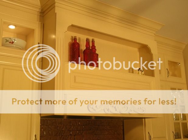

Our ceilings are also 9 foot. We did 4" furring strip and a 5" crown. Looks like this:

Caspian, thanks for the tips. So does that mean you used 3 pieces? an L shaped piece, then a 4 inch crown piece and then a 6 inch board? I am wondering if I can skip the L shaped piece since it sits behind the other pieces?
Taggie, thanks for the pics. Did you also add an extra decorative rope piece at the bottom of the 5 inch crown piece (or is that what you mean by 4 inch furring strip, sorry i don't know what a furring strip is..)?
Also, I am wondering if there will be a line/gap that shows where you put the two pieces together so that you need to cover it with a small molding piece like the rope molding?
RE: stacked crown moldings size
Sorry michoumonster, I might have the terms wrong. By furring strip I meant the flat piece below the crown ... the rope molding is attached about 2/3 of the way up the 'furring strip' or whatevertheheck it's called. :) So the crown starts approx an inch above the rope. Hopefully that makes sense.

Ah I see. Thanks for the clarification Taggie! So the rope is purely decorative and isn't needed to hide any seams. I see now how you put the crown slightly forward of the 4 inch base to avoid seams. thanks again! I enjoy seeing the pics of your beautiful kitchen.
