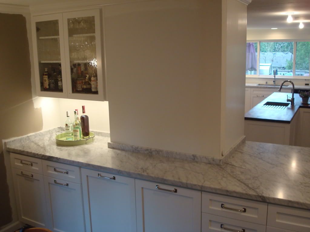

Here's my 2" splashlette if it helps. It does the job of protecting (and hiding) the seam where the stone meets the wall while still not looking obtrusive and catching the eye too much.

I do really like yours Breezy. Is yours 2 cm thick?

Yes, the splashlette is 2cm thick. My counters are 4cm so they had to fabricate the spashlette from a different slab. The whole installation was unplanned anyway due to their error in cutting.
In re-reading your OP, I noticed that a 6" splash will come up to the bottom of the window sill. Is that right? If you go that route, at least you'll be lining the stone strip up with an existing element in the room so it wouldn't look so out of place. With a window 6" above counter, a little 2" strip of stone would leave abbot 4" of drywall. Would you like a little strip of painted drywall showing like that?
