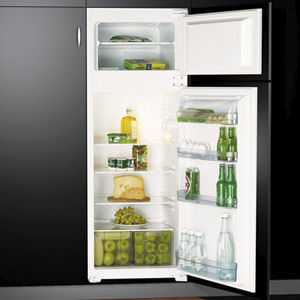

This one is from their catalog -- do the open doors render this useless?

Thanks, all.
What I can't figure out is whether you have to expose a thin strip of cabinet frame on the hinge side--since it's a French door that means 2 sides. I want to see only doors all the way across. They don't do a good job of showing this one way or another.

Thanks. Looks to me that the hinge side does need to show a bit of cabinet. Darn it.
