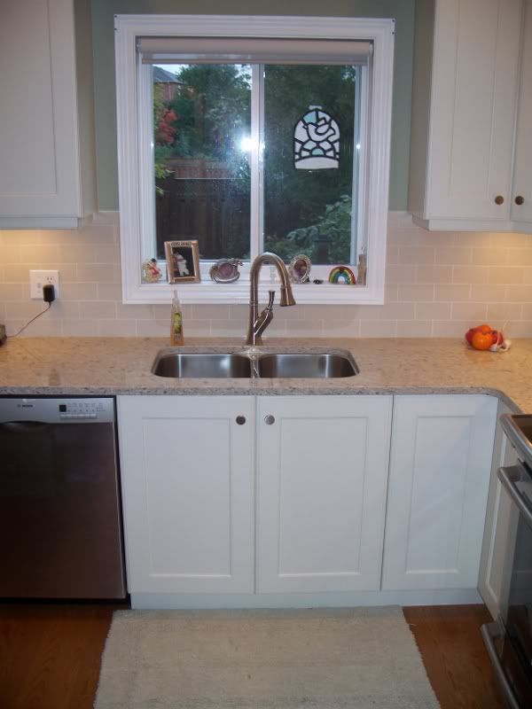

I think I have what you're describing: I have Cambria on my island which is 103" long, 50" wide at it's widest with a 27" "panhandle." My sink run it also L-shaped and is 117" with ~40" L next to my stove. I see on the dupont website that slabs are 55x120." The only reason I see to be "squeamish" is the additional cost of using more than one slab if needed (ie: if your whole kitchen could be done with 1 slab with seams, vs. 2 slabs without).
we love this island!
new view kitchen sink
