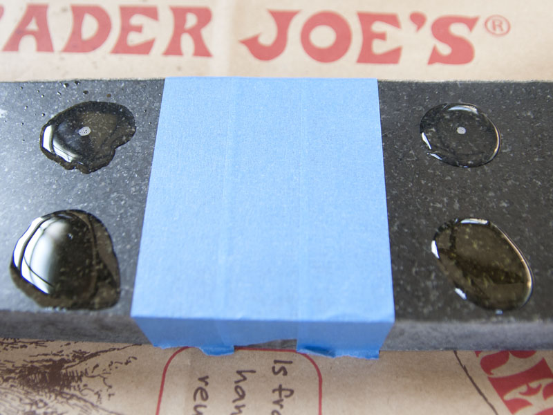

    My granite will be installed tomorrow. I got a piece of the slab yesterday with enhancer on half of it. The enhancer makes the honed surface darker and a bit duller. Fingerprints do not show on the enhanced side.
    I decided to do the lemon juice and oil test - see link and images below. Untreated is on the left and enhancer is on the right. The top is lemon and the bottom is oil and I left them on for 30 minutes. Since my granite is honed I would expect the oil to darken the untreated side and you can see the slight mark it left behind. The lemon did not etch the untreated side or haze the enhanced side. I did not have any granite cleaner but wiping some lemon juice and then water over the untreated side returned it to a uniform finish.
    I imagine that the Method granite polish does something similar to the enhancer. It is still not clear to me which is the better solution, enhancer or method polish, or if they work well together.
    Rupert

    rupes --- am I seeing things in your last photo? ... it looks like there is a dark spot where the oil was.
    Is "Method granite polish" different than what I have, "Method Daily Granite (granite + stone cleaner?)"
  • rupes
    12 years ago
    lolauren you are not seeing things. As I mentioned above the oil left behind a mark on the untreated side but I would expect this on a honed surface.
    We are talking about the same polish. oldhouse1 refers to it as MDGP.
  • lolauren
    12 years ago
    Oops. I misread what you had posted. :) I'm curious how long that oil mark sticks around...
    I just grabbed a remnant of my unsealed, honed (Cambrian black) granite. I applied Method to a portion of it and let it dry repeatedly (about 10 times.) I cannot see a difference in darkness between the portion I tested and the portion I didn't test...
    So, no, I don't think Method will make your granite look like the sealer did....

    I did the lime juice, oil, hard water & soft water test as well..
    My hard water dries and leaves a mark around the edges, but I can rub those away. The cleaners help that process.
    Lime juice did nothing. Oil darkened the stone, the same as pictured above.
    I am not having any success getting the oil marks out, even with cleaners or soap.
  • oldhouse1
    12 years ago
    lolauren, I tested the oil on a sample with enhancer on it. Are you doing the same? If not, maybe that is the difference? Method cleaner has corn/coconut surfactant in it which must mean oil. Perhaps after a period of time it acts as a protectant. I don't know, this is like the blind leading the blind, isn't it?
  • lolauren
    12 years ago
    That is the difference. It has no enhancer. So, the enhancer, apparently, does help protect the stone from oil?
    Yes, Method has oil..... so I agree it must build up over a period of time.
