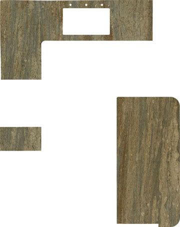

    I know that not all fabricators have high tech equipment, some still use paper or luan templates or even just masking tape, but that is no excuse for requiring the buyer to accept whatever strikes their fancy on any given day. This is one of the two potential layouts that our fabricator emailed us before cutting. We knew exactly what was arriving. This used 2 slabs, but no seams.
