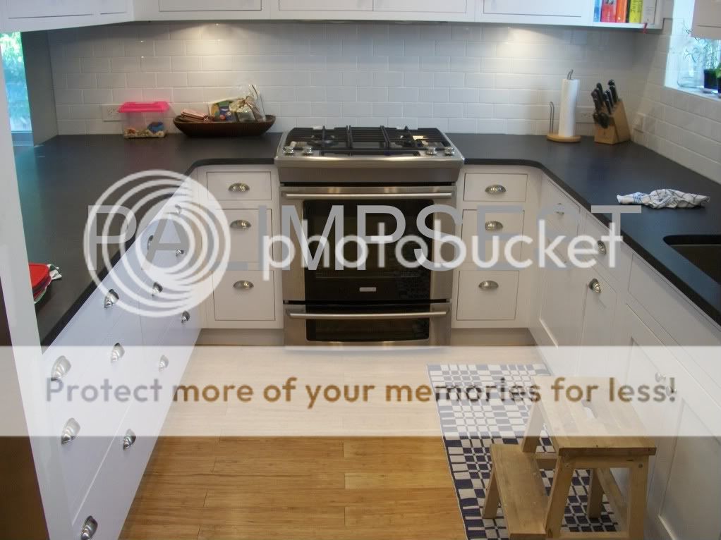

On a project we had the electrician leave an extra long tail of wire and the carpenter put a horizontal nailer between the studs at 39" above the finished floor all along the backsplash. (for one row of tile between countertop and outlet, you could do any X multiple of 3" above the countertop for X rows of tile)
We did not have the electrician affix any boxes until the subway tile was figured out. When the subway tile pattern was determined the boxes were placed horizontally so that they aligned with the tile perfectly: each box fits within one tile and the only cut tile is the extra two inches that make up the 6" of the tile, since the box is 4" long.
So each outlet and plate fits into the over all pattern.
Did the electrician like doing this? No, he was annoyed. But it looks great.
RE: electrical outlets in the kitchen backsplash
palimpsest, do you have any pictures you can share? Thanks.

Here you go. Its the best picture I have :
