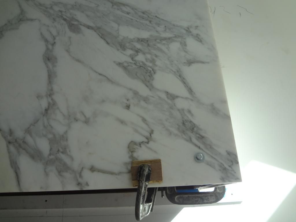

    Today the Vent-a-Hood went in. They left this third side open so that they had room to work. The final panel of marble got put in in the afternoon but I didn't get a chance to photograph it yet.
    Here is a close up of the rivets. I had originally thought to completely covering these, but am now thinking of making them look "industrial" and putting half-dome stainless covers over these. What do you think? Should I do stiles or rivets?
  • christina222_gw
    9 years ago
    I like the rivets with just the domes. I think covering them with stiles would disturb the clean lines of the stone that everyone has worked so hard to achieve.

  • chicagoans
    9 years ago
    I also like just the rivets with domes. From a distance you don't even see the rivets, but stiles you would definitely see. It would be tough to match the veining of the marble and I just don't think it would look as sleek.
    If you're worried about seeing the domes over the rivets, I think it would be pretty easy to paint them white (before installing) and then paint on some light veining after installing to blend in with the marble. But honestly, I don't think others will notice them.

  • firstmmo
    9 years ago
    Here is a SketchUp of the stiles. This is what I had thought would cover the rivets. Now that the rivets are in, it's very hard to see them. I am definitely looking at covering them with domed caps (see link below).
    You can see the screws below. There are four on each side, including the side panels:
    Here is a link that might be useful: Screw covers

  • firstmmo
    9 years ago
    Final side went up:
    They will be bolting that final side and then snipping the ends, then I need to figure out how I will cover these. Looking at a few options, but for now, I do love that clean look. A stainless metal piece will cover the underside rust colored frame, which should also be installed this week. Can't wait to see the backsplash too!
    Somehow we are going to be all done in 5 weeks. I think a lot is going to happen between today and June 27th!
