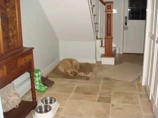

We left the area under our new stairs open so we could put our dog's bed under there. Under the dog's bed is the hatchway to the crawl space/cold storage.

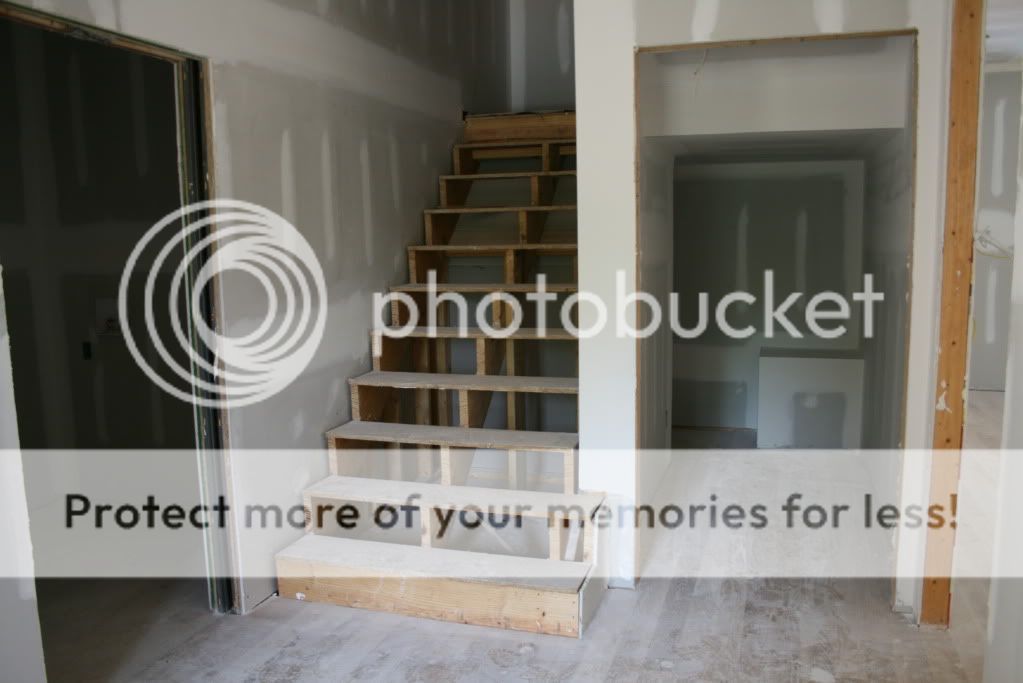

here is a picture of my 'under the stairs'. work in progress...
Here is a link that might be useful: gutted under the stairs
