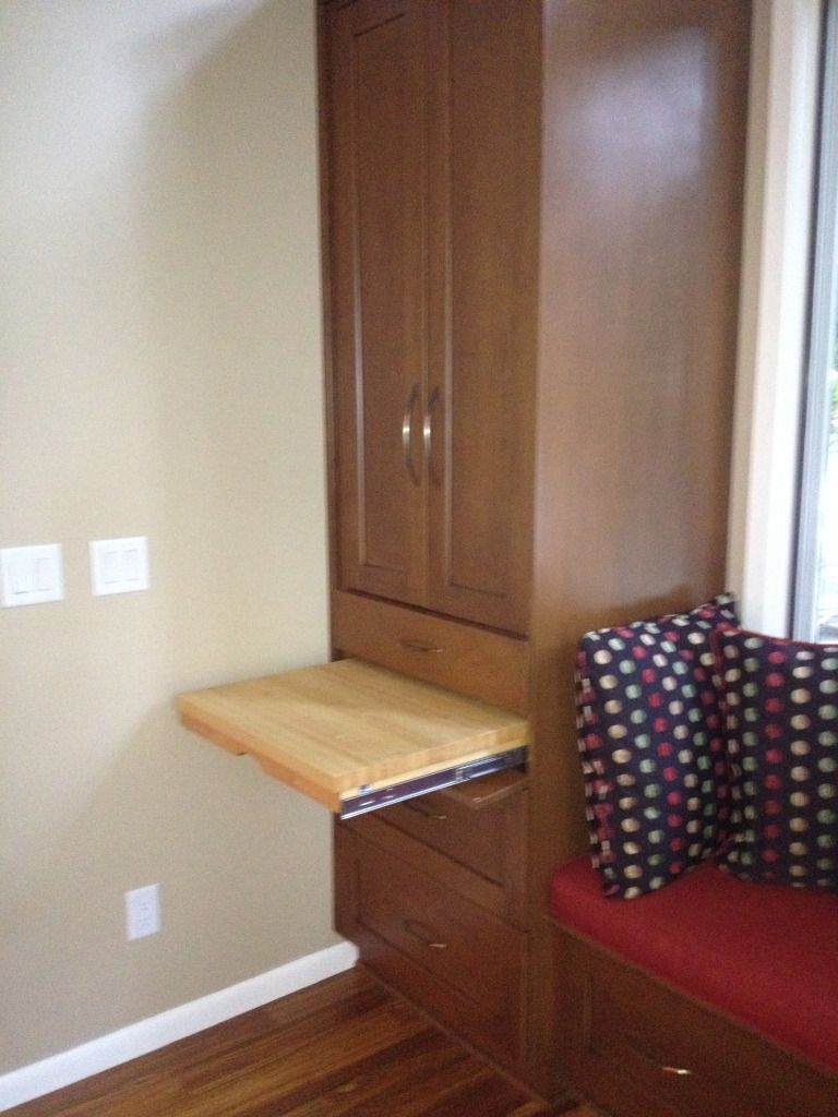

Wow! You have a ways to go on figuring it all out.
Not much help in the big picture but here is our bench to get your ideas flowing.
The bench does have a back - but we can fold it down (piano hinge) when we want an unobstructed view out the window.
We put a his and her "cave" on either side of the bench. The cave has a pull out work surface and the top doors open "entertainment style" which includes power for toys and two pull out drawers
RE: I really need layout help! Please!
That is really nice! I guess I should have proofread my post! Haha, it appears as though I can not speak or type! Thanks again for the input!
