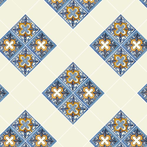

@suzannesl - do you know where you got the image with the Blue diagonal tile set in white? The 3rd "row" of your post.
