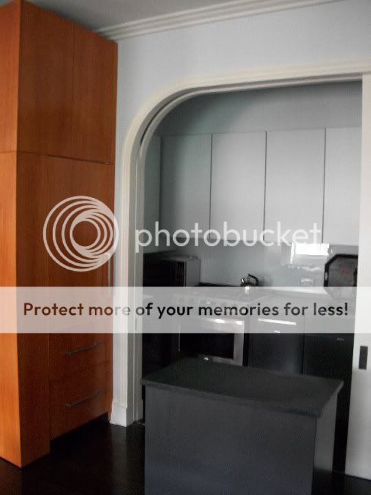

    Hollysprings, why does the wall need to be really flat? Currently there are several holes left in the wall where the backsplash will be and I am not sure the contractor was planning on covering them up. Surprisingly, he has not been around all week to ask.
    robbbcs3, parapan and zenolite look like cool products, but I am not sure an acrylic product would be good for a backsplash behind a cooktop.
    millworkman, actually the cost that is contracted for runs $35 a sq foot. If the contractor can pull this off, I think it is pretty reasonable. We are talking about two areas for a total of about 53 sq feet so if I were to pay in the $55 - $60 range, it would be much more expensive and not very affordable.
    I have looked into some other options with my kitchen designer. We can just do 4x8 inch glass squares or we can go with a more retro matte ceramic tile (the house was built in 1952). We are looking to do modern, clean lines so these options would make it a bit more busy.
    We can also order cut glass squares to size like in this photo that would eliminate a lot of the grout lines:
    [Modern Kitchen[(https://www.houzz.com/photos/modern-kitchen-ideas-phbr1-bp~t_709~s_2105) by University Place General Contractors REIER Construction
    I am waiting to hear back from the designer on the costs of these other options.
    The wall has to be flat because glass doesn't bend. It breaks instead. You can't glue glass to a wall with humps and bows to it. It's like super large format tile. And yes, every time I had a client interested in it, around $50-$75 was the going rate. It depended on how many electrical outlets had to be cut out in it. The glass has to be cut perfect and then tempered. Non tempered glass is NOT an option, but I'd bet that's what your contractor is actually planning to do at that price level. If regular glass gets hit by a hot spatter of grease and shatters, you've got sharp shards that can cut you. Tempered might shatter, but the pieces won't cut you.
