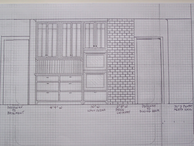

Here are my elevation drawings - please note that they're rough and that cabinet styles, numbers/positions of drawers, etc. are VERY much subject to change, especially with the wisdom of GW applied!
Here's the wall w/ chimney - "bottom" of layout, wall that is shared w/ dining rm.:
From Kitchen Interior Elevations
That's beadboard as backslpash between upper & lower cabs (which will probably be quarter-sawn white oak), & we're thinking of some sort of message center (thanks again, lavender lass!) & display area in front of exposed brick chimney, allowing brick to remain visible.

JBGB, I think it looks extremely nice and would be a pleasure to work in. Actually, I love it. You've done such a wonderful job of fitting in what you want. Your elevations...extremely nice! :)
I'd still shorten the island and get it out of the traffic (and view) line through the house, even if it meant moving the prep sink across from the stove. I believe you passed on that one, though, and the sink is really good where you have it.
