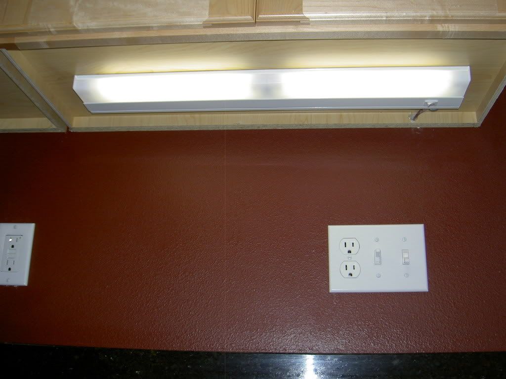

    I have T5 Thin profile fluorescents from Pegasus lighting. Wish I'd done the corner too.
    At a distance and stooping so the fixtures are visible:
    Close up:

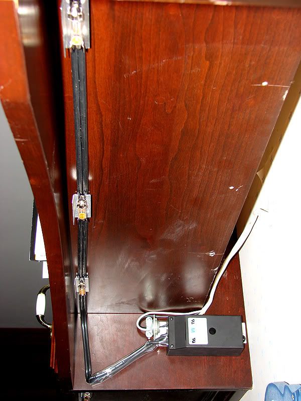

    We are using SeaGull Ambiance linear track lighting and love it! It takes a little more time to install and requires its own transformer but I love the lighting coverage. With dimmer switches we can go from bright task lighting to subtle mood lighting anytime we want. I use my undercabinet lights all the time, even before the recessed can lights.
    View of lighting track and lights with transformer under the cabinet:

    Is this the Seagull lighting you're referring to? It does look nice in your pictures; I think I might like the track idea better than the rectangular fixture. Does the fact that it's low voltage mean you need the transformer?

    Yes Snowyshasta that link is the one for our Seagull lighting. You will need a low voltage transformer, either an electronic one or a magnetic one depending on how many lights you want to put on one line. Electronic transformers are smaller and easier to hide but have a 150W limit. I used 10W bulbs so that was 15 bulbs max per electronic transformer. You can put more wattage on a magnetic transformer but they can get fairly large.
    If you want the undercabinet lights to be on dimmer switches you will need to get the dimmer to match the type of transformer you use, ie. low voltage electronic dimmer for an electronic transformer. The technical support staff at Seagull is pretty helpful if you have questions. You can also probably find a local lighting supply store who sells the parts and can also give you install advice.

    Can you give some more details about your install? What spacing did you use with the 10W bulbs (looks dramatically different between the two installs.
    Was planning on one monster magnetic transformer, but the smaller ones may make installation easier. Can you tie multiple (4 or 5) smaller transformers together to be controlled by a single dimmer? Can they be placed on top of the cabinets and hidden by the crown? Is a light rail necessary? What gauge wire did you use in wall? ....etc., etc.
    Any install details would be appreciated.
