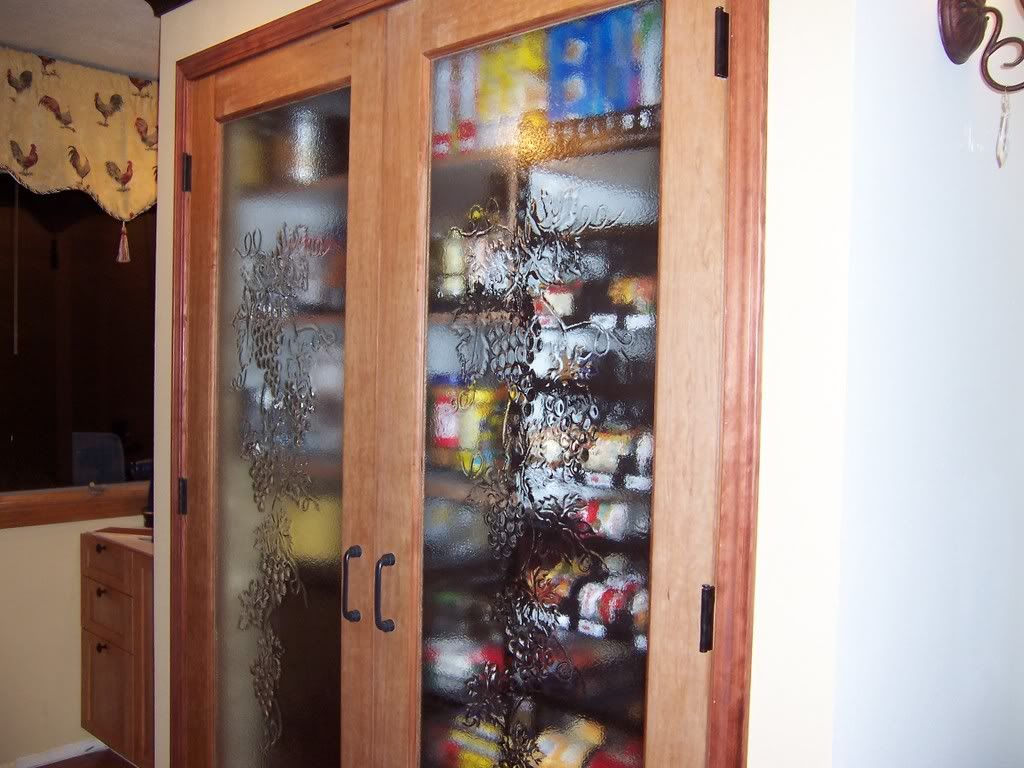

Mine is similar, but it butts up to a doorway, not a cabinet/counter. The top shelf is 9" deep, the 2nd & 3rd are 12" deep, the 4th 18", and the bottom 12". On the left side the top shelf is 9" deep and the rest are all 12". On the right all shelves are 8" deep.

Claybabe and Natal, those are fantastic pantry spaces. If I would've seen pantries like yours or like the one Vicnsb found, I probably would've designed my kitchen much differently! I almost didn't have any pantry, but I probably could have fit one like yours in...I thought any cabinet depth pantry would have to be a 'pantry cabinet,' which don't work for me. I just didn't realize how much you could do with the seemingly little space. In fact, I wish I could now add about 3 such places in my house...For linens, and for puzzles and games. :-)

Claybabe and Natal...thanks for the photos, I really like your pantries!
Claybabe, your glass is really nice...I don't remember seeing this when
looking at photos of your kitchen.
