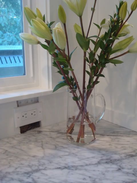

Hers a picture of the bottom of my widest kitchen window to show you what I meant about the trim. Annie's diagram is most helpful.
Hortizontal outlet under window
