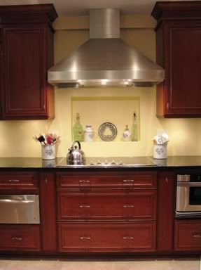

    Buehl, do you have 8 ft ceilings? (I'm trying to figure out what style of hood to use over induction and looking for pix of different options for an 8 ft height.)
  • Buehl
    Lori: Yes, we have 8' ceilings - for the most part. It varies by an inch or two throughout the kitchen. (That's why the "filler" piece was so important in the crown molding on the top of the cabinets - it allowed us to adjust the crown to fit the actual ceiling height w/o affecting the decorative pieces of crown and w/o making it obvious there was a difference.)
    Here's a straight-on shot of the hood. Note the small soffit - it was needed b/c about 3 or 4 inches of PVC pipe stuck out beyond the upper cabs on the right. The soffit was extended the entire width of the opening b/w the cabs for a symmetrical look. (There was no need for it at all on the left side of the hood.)

    Creative solutions, Buehl-- you'd never know. I live in a 1919 house now, and there doesn't seem to be a "planar" surface in it! That's one thing I'm looking forward to with new construction!
    Does your shallow drawer under the cooktop open?

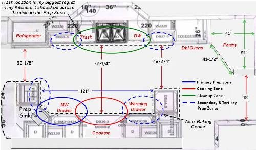

    Buehl, how much space between your frig and peninsula? The peninsula in my much planned-but-may-never-get-to remodel is going to be about 52" long, then floor space (hopefully 36"), then counter-depth frig. The width of my kitchen is only 10 feet. Your space looks like how mine may turn out...
  • Buehl
    KBSpider: Lol! You will have more room than I have! That space, or "pinch point" as we like to call it (courtesy of someone on GW), is one of the things our KD messed up on...at least indirectly.
    Originally, we were supposed to have 42" - a nice aisle width b/c of the refrigerator. However, our KD really made a mess of the measurements in our kitchen (long, long, long story) plus we had to build out the cooktop wall in our kitchen by 6"....so we ended up with...32-1/8"...yes, that's right, less than 33"!
    I was upset initially about it until someone on GW reminded me that we most doorways are around 32"...so in normal use it wouldn't be an issue. The difference here is that we have a refrigerator that opens into that aisle & there is not enough room for someone to pass by when the refrigerator doors are open and someone is rummaging around in it.
    In reality, it's rare that someone wants to get by when someone else is using the refrigerator. Do I wish I had more space there? Absolutely! Can I live with it? Yes.... It's one of those things that I had to "make do with" b/c the cabinets were already onsite and I wanted a peninsula that seated two comfortably and would work as another workspace and staging place for food for the DR.

    Buehl, thanks so much for letting me know the width, and how it's working for you - the floor plan is a bonus! I've been toying with the idea of making the peninsula a teensy bit longer, cause 52" seems a little tight. That would knock down the space to 33", but the frig won't be directly across from the aisle (kinda kitty corner), so may be even less of an issue than yours (at least, if the latest plan I've done actually ends up being THE plan...lol). Of course, 3" isn't all that much extra, either...decisions, decisions! Thanks again - it's a big help!
