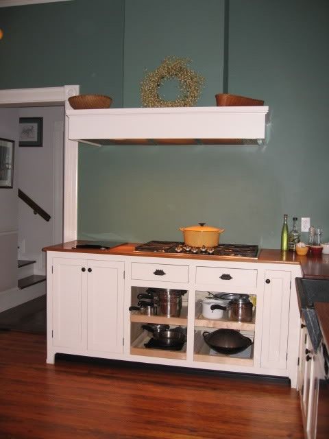

Our wood hood is 32" above the countertop/stove top. our Kitchenaid range suggested 42" but after we looked at our specs for other stoves, we decided that seemed ridiculous.It didn't seem like it would able to capture any smoke that high off the range. Here's a picture... I'm 5'7 and even though I don't have use of my range yet (obviously), its going to be fine.
