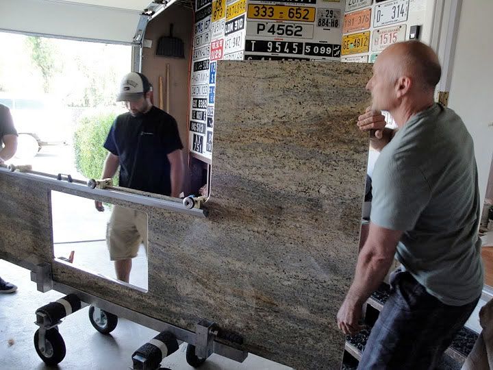

    Just happen to have a photo of a tool that keeps "stone from breaking during transport."

    suzannesl:
    That's exactly what I'm talking about. That's much stronger than any rod and can usually be removed after the top is safely lying on the cabinets.
    It installs and removes in less than a minute. I'd be surprised if anyone could rod a top in less than half an hour.
