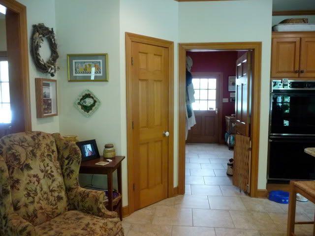

Here's the main view:Photobucket
Here one of the main shelves and you can see the 6" section to the right
A better view of one of the 6" sections:

I tried to measure the floor space, but it's such a wacky layout... anyway....
Measuring along the floor going near the door casings, I've got almost 2.5' on the short sides, 4.5' going along the floor across in front of the shelving with the stenciling and then about 4' going in the other direction.
My door is 2'.
As you can see from the photos, it isn't squarely in the corner and extends back into the hallway where our half bath is located.
