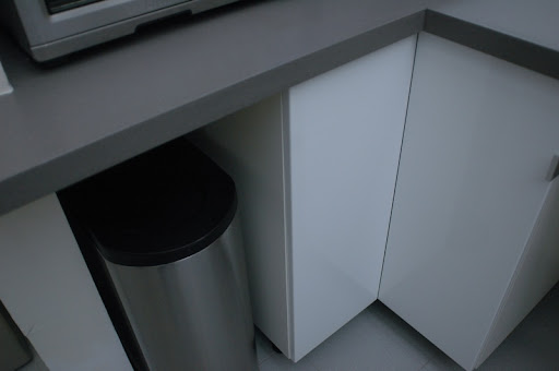

OK, here's one. I found it by searching on "niche," but it's not the photo I was thinking of.
Grrr. This is exactly like not being able to remember an actor's name and having it completely take over your brain until you think of it.

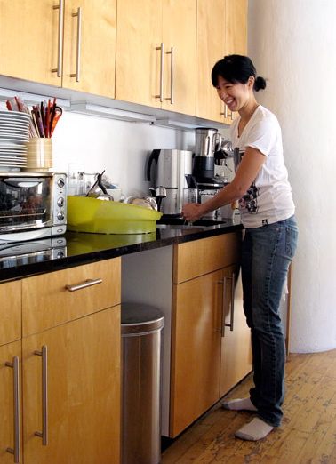

RE: Cabinet cut out for garbage can
A-ha! Here you go.
I confess, to me it looks a bit odd and difficult to use.

Thank you so much! I just discovered this forum yesterday and I'm so glad I did before these final decisions are made. I stayed up half the night reading posts.
The photos you've posted are exactly what I was envisioning but after seeing it I think I would be disappointed with that. I'm now wondering if I could reconfigure the island so that the niche is in the end of the island (across from the d/w and much less visible).
