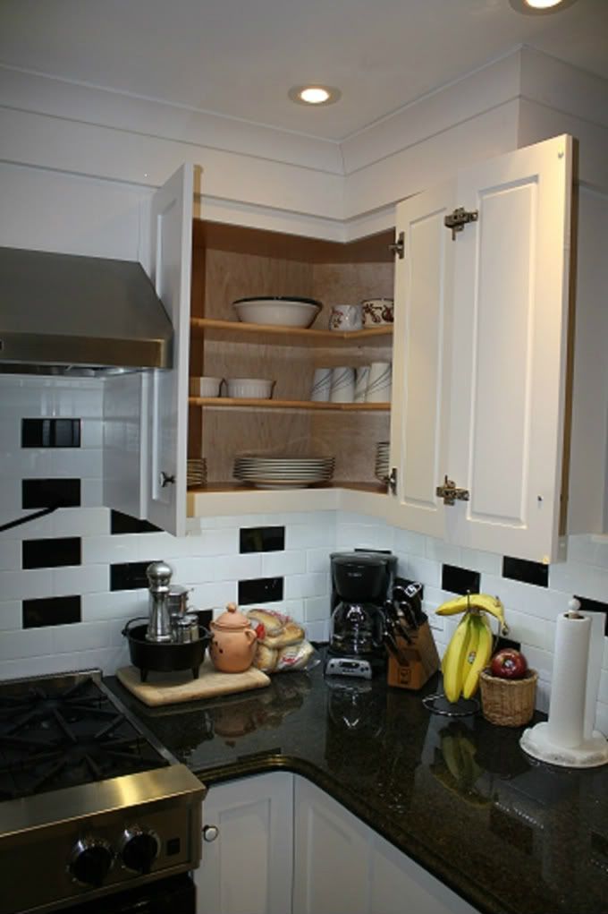

  • willtv
    skeylargo,
    I should have read your post more closely. Given your choices, I think I'd go with a diagonal & a lazy or super susan.
    OntarioMom, The cabinet with the double hinged door is generally referred to as an easy reach. Our cabs are custom made so we had them extend the left side of the cab by about 10" to eliminate what would otherwise have been a 9" cabinet between the range hood and a conventional easy reach. This way we eliminate the dividing cabinet wall and gain more space. It was also a less costly to do this than to build the 9" cabinet.

  • willtv
    skeylargo ,
    The 3 doors on the easy reach are 10".
    It's been 2 1/2 years and no sagging yet.
    To the right of the easy reach is a separate cabinet that's about 11 1/2".
    Here are a few shots that might help.
    Closed
    Right Cab Open
    Easy Reach Open
    HTH.
    Ontario,
    We keep our dishes in the easy reach too.
    You do have to be careful when opening the easy reach door, but there are ways to restrain their swing.
    Also, we have no kids so it's not really an issue for us.
