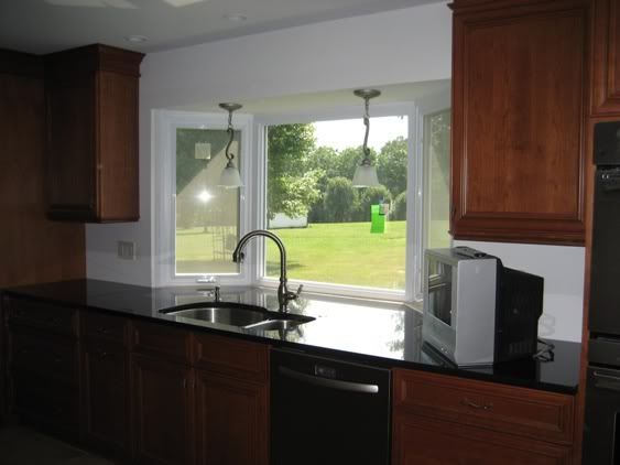

Hi--I am also curious about mama's little window bumpout--a great feature--but is it there because the walls are so thick, or what? I have asked for this arrangement in our redo but since it will be a retrofit it will be trickier. I didn't realize your window bumped out, mama. thanks!

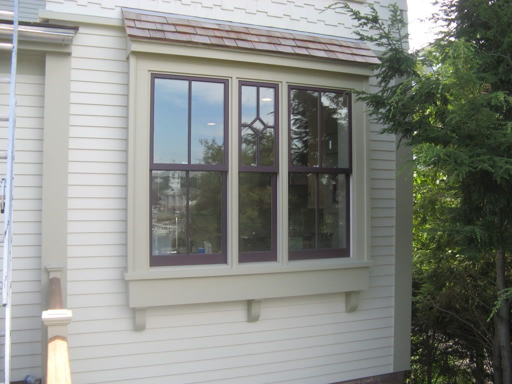

I had to go with marvin because we are in the historic district. they are all wood and met the standards of our town. i had the casement before and hated them as they broke and in order to get them to close I would have to go outside and push them shut.

we designed the bumpout. i wanted the extra counterspace and it has been great. I am going to post a pic so you can see the outside. our kitchen is actually a full story off the ground because of the steep grade from the front of our house to the back. btw, holly, what is happening with your renovation? I hope all is well.

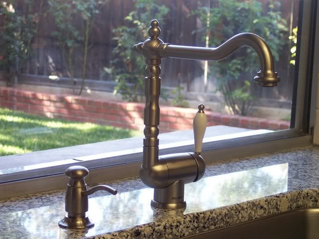

Here's ours. No bumpout, South facing and glare (doesn't bother us though)
RE: pros and cons of windows that go all the way down to the coun
marzhere - where are your outlets along that wall though? makes prep work difficult.
You can barely see an outlet in each of the pictures, those are the only ones on that wall. We don't use that wall for prepwork. All that is done elsewhere.
