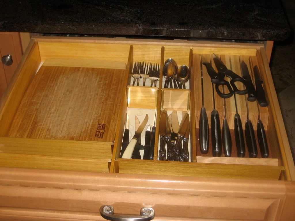

    I looked and was unable to find nicely made hardwood drawer organizers. So I made some that really turned out well. And the woodworking skills needed are easy enough that even a beginner woodworker can do an excellent job.

    Bob, are those based in the Lee Valley brackets? I know they have thingies that are similar, but I'm not sure if they look that good.

    Fori, yes, Bob_cville used the Lee Valley brackets for his dividers -- I'd been wondering about them and when Bob posted his pics earlier, I was thrilled to hear and see how well they worked. He really did a beautiful job!

    As several people have confirmed, the drawer dividers I made use the Lee Valley brackets. I also used 1/4" thick 4" wide poplar boards from Lowe's.
    So all I needed to do was rip the boards to width (I used a table saw, but you could probably use a circular saw and a straight edge.) And then carefully cut the boards to length (I used a sliding miter saw, but you could also use a miter box and a sharp hand saw, or a square and a circular saw.)
    Most of the dividers are about 3 1/2" tall, but for the silverware dividers, I made them about 2" tall to make reaching the silverware easier.
    I also considered making frames within the drawer like lowspark did, but I decided that I like the look without frames. Also even if I decide to remove the dividers, the holes made by the sharp prongs on the brass dividers are small enough that they'd probably never be noticed.
