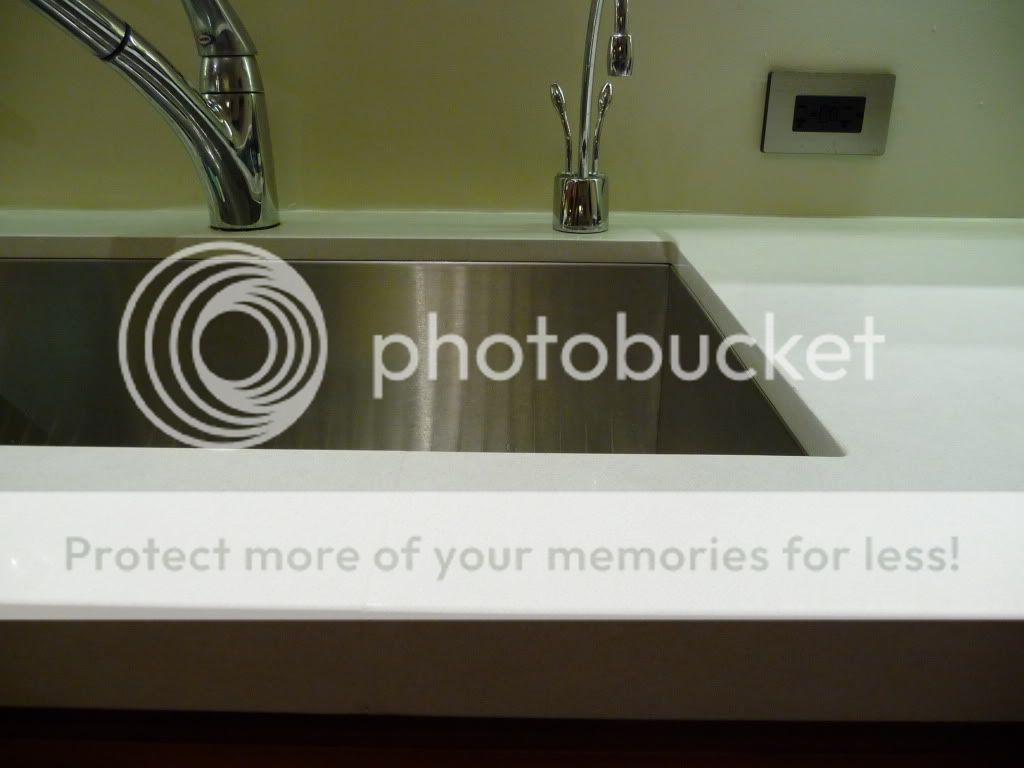

  • gwentm
    13 years ago
    Here's the seam at the sink of my quartz countertop
  • emily_mb
    13 years ago
    gwentm, I don't see a seam! I assume that it is in the center. If I can get anything as well done as this, I'm saving a lot of money.

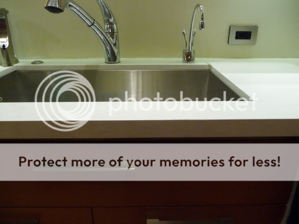

  • gwentm
    13 years ago
    The seam is to the right of center, just to the left of the insinkerator in front and in the back. If you look closely you can see it. It is a little more obvious in person but not objectionable at all. They couldn't put the seam in the center of the sink so my choices were this or a full seam in the counter. I actually like it this way because it is not center which might have made it more noticable. My quartz is whitish with a little gray tint. The installer blended it well.
    Here's a closer look where you can see it better.
