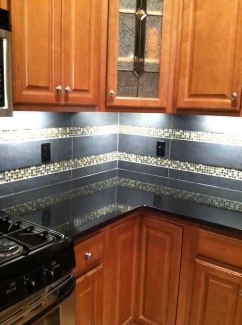

Hello,
I have Stonepeak Ceramics Parkland Acadia tile in 6 x 24. Mine makes me think of black suede, I LOVE it! It is a rectified porcelain. Here are some pics of my backsplash.
