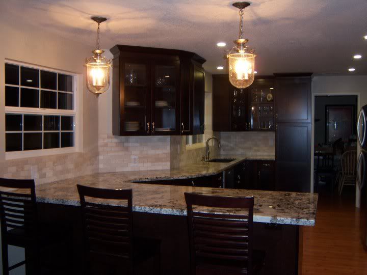

    Hi dianelouise..
    I just stopped the subway tiles. I didn't use any edging. I like the way it came out...however I have seen edging on others and I think that looks good too..Here are some shots of mine, but they are kind of at a distance.

    Dear kitchenaddict, your backsplash is lovely! May I ask what kind of tile that is?

    Hi marcydc...
    Thank you..It's called Crema Marfil Tumbled Marble. I found it at Arizona Tile.
