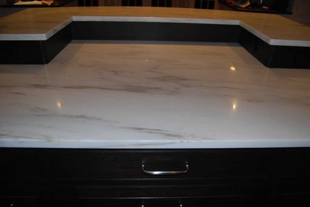

I thought some pictures of my island's Danby Marble might help make this thread more meaningful for those who might not know what it looks like yet. Pictures don't quite capture how dreamy and beautiful this stone is! We etched it quite easily, however, with a bottle of red wine that had a drip go down the side of the bottle after pouring. The drip made a ring that was there for about 30 seconds before I wiped it up. Oh well, it's like that first ding on a new car. I put it on my island knowing it'd get well used, LOL! No stain at all, btw, and of course we had it sealed.
RE: My Danby Marble Tests...
It looks positively scrumtious. Thanks for the photo!

Smarge - your Danby Imperial is beautiful! If you don't mind me asking, what did you seal it with and how often have you done it? Anyone else out there with Danby marble - please chime in!
Thank you, tantadoodles. I sealed it with "MB Stone Care MB-4 Stone and More Impregnator/Sealer" which is supposed to last 10 years according to the label. (The owner of the company is a guy named Maurizio, who is pretty much of a stone expert on the internet. He sure knows more than I!)
I have to say that since posting my picture, I have further etched the heck out of the island with plain water, tomato juice (wiped up without staining, but left an etch mark), etc. It is going to etch like crazy and I'm not worrying about it. All the marble in our house is etching from plain water droplets, and we have a water-softener and whole house filter!
I bought our Danby at Dente Trading Co., Inc. in NJ. they had both honed and polished and the honed was dull and pretty boring. The polishing really brings out the colorful swirls you see in my picture above.
Our fabricator (Globe) offered to do a lower polish level for the marble, to more closely match the duller sheen of the perimeter counters, which are Caesarstone Raven. (For those who don't know, the manmade quartz countertops have a less shiny polished finish than regularly polished granite and marble.)
Knowing what I know now, I'd still get the same marble, polished. Just know it won't look perfect or brand new for long.
