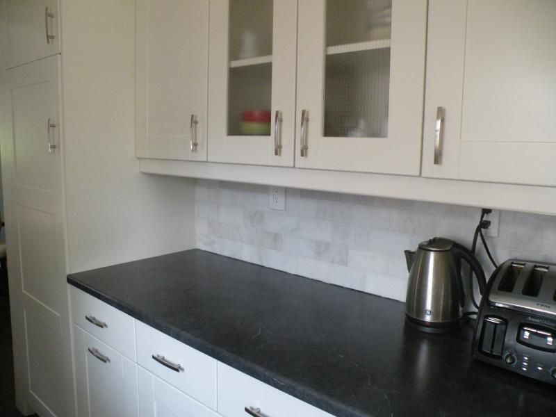

  • mgmum
    9 years ago
    Mine is WilsonArt Black Alicante. I have a matte type surface. I did not like how the sun shone on the textured finishes and you coudn't see the counter pattern, just the texture. I'm not sure mine came in a texture anyway. Most of the mini samples at the big box stores have the types of textures available. Some also come only in super glossy, and those I did not like that much either, but that's a personal thing. I think you can even get an 'ogee' edge with laminate now.
    Your KD needs to school him/herself on this because not everyone can afford or wants a solid surface or stone countertop. No way could I afford solid surface or stone. I suppose I could have found some granite remnants with a good deal of searching, but I like what I have and I liked the price too. :)
