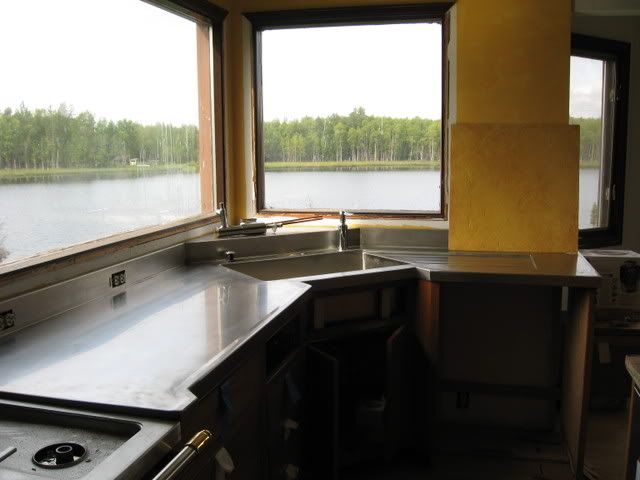

    we did inset it about 3 inches on each side which is a nice feature this is a pic before counters and dishwasher...

  • igloochic
    15 years ago
    I have stainless counters, and had them made with runnels to the sink from the right hand side where we drain dishes. My sink is also set in 3" so you are not trapped or unable to open the dishwasher when it's right next to you. If I'd done this in granite, I'd have also had the runnels made (it's actually easier in stone than in stainless).
    The only reason a corner sink would be set back further would be if you purchased a sink too large for your cabinet. Mine is 3" back, standard for a sink.

    igloochick,
    Thank you for the prompt feedback and the great pictures. I had thought about adding the slope and contour as you have done. Small concerns about keeping it clean and potential sealing issues in stone. Thank you though as this is definately a potential solution to the dilema.
    btw.. beautiful view out your window.
    I am still curious how others accomplish this as none of the other pictures in this thread included the "runnels" in the countertop by the sink. Runnels is not a term I was familar with, but I've learned something new already.

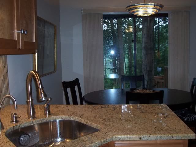

  • writersblock (9b/10a)
    15 years ago
    lnersesian, which sink is that? (very handsome kitchen, incidentally)

    I know I saw a few sinks with stone counters on GS in the FKB somewhere that have drain boards or runnels (what they call the raised up area). Mine does not show the slope well, but it does slope down into the sink about the thickness of a sheet of plywood total from top of the hill to the bottom (counters are built with two sheets, with the drain board cut out of the top one). Try "drain boards" in a search and see what you get :)
  • sunfeather
    15 years ago
    lnersesian - I like your backsplash. I hope you can tell me the name/color of the tile.
