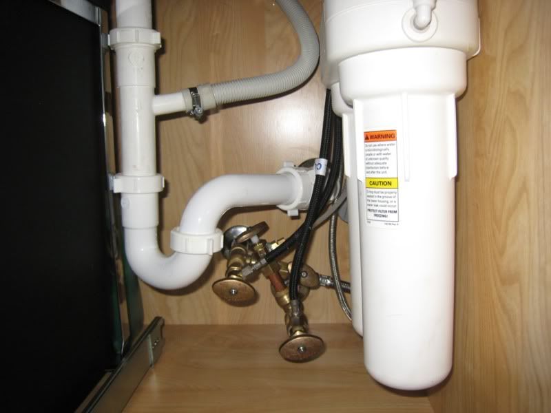

    My sink cabinet size is 27" and I couldn't find a reasonably priced undermount offset drain sink, so I asked the plumber to squeeze the plumbing in the right rear of the sink. I purchased a Kohler D bowl sink with the drain in the rear.
    My little sink cabinet holds my trash pullout on the left - the Simplehuman pullout fit perfectly, the large dish detergent bottle for the soap dispenser behind it. The plumbing and cold water filter in the right rear and a small recycling container in the right side front. Works very well for me.
