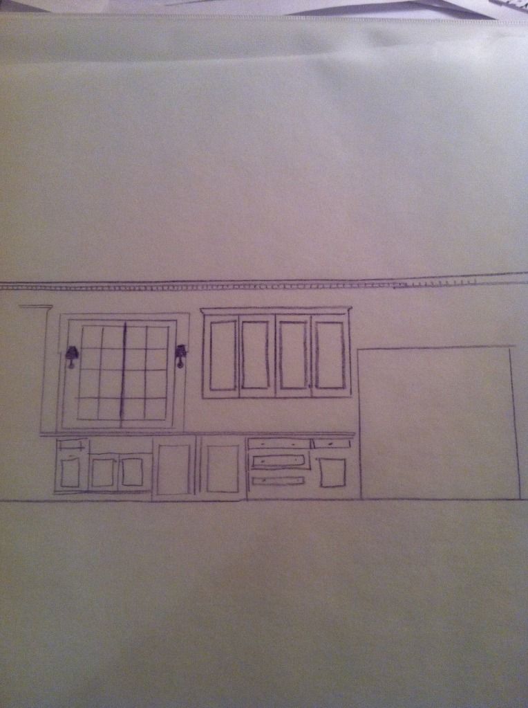

what i have designed now:
fridge wall and range wall
drawing i just did for range wall:
Kitchen option, Uploaded with Snapbucket
island and hutch

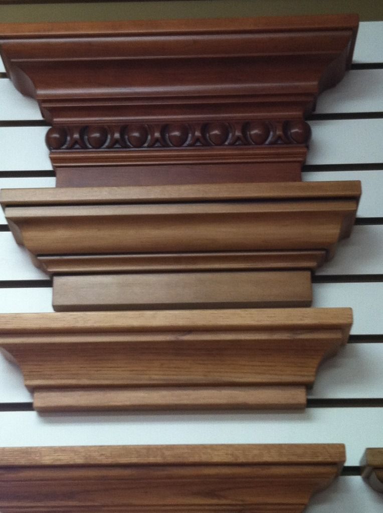

I want to keep it simple. Should I eliminate crown molding in the room?

Do you have crown molding in the rooms that open up to the kitchen?

We have an 8 in tall dentil molding in the formal room this can be seen from and a very simple molding in the other rooms that the kitchen is connected to.

thanks, palimpsest. i'll try to come up with a drawing of this wall and get back to brainstorming for the fridge wall.
should i decrease the width of the uppers on the sink wall so they don't end where the lowers do?
RE: Please help me achieve this (new) look...
"should i decrease the width of the uppers on the sink wall so they don't end where the lowers do?"
I don't think this is necessary. Are these custom? If so you could make the "reveal" on each side of the window even.

they are custom. the reveal on each side of the window will be even if we do the ceiling to counter cab on the range wall the right depth. the trick will be mounting sconces on the window casing. any suggestions with that?

I'm going to try to do a drawing of the sink and fridge walls now with cabinets that don't go to the ceiling. I'm sort of wondering why I'm doing this and not the designer! Anyway, I'll post what I have in a bit.
By the way, yes, I alerted my husband to the durability of wood island tops and he certainly knows marble isn't tough (I chose the marble after being tired of looking) but he doesn't believe what he hears about the wood. Don't get me started......
so if i take the sink wall cabinets down from the ceiling do i need to do the same with the single cabinet on the range wall and the cabinets on the fridge wall? here's a little drawing i did of the sink wall with the cabinets brought down. i didn't want to bring them down to the counter because i need counter space. Uploaded with Snapbucket
I think this is working. I emailed you, too. It may be easier for you to convey this on paper by doing it yourself rather than trying to explain it to your designer, who may not quite get what what you are driving at without a visual.

Is Plain English building your cabinets? I have an English style kitchen, and love the general style of the Plain English kitchens you linked. The emphasis there is on "plain". This style takes its cue from the kitchens of the old aristocratic mansions, which were simple and functional, where the servants worked. Later, when kitchens in upscale houses were used by the homeowner, I suppose they became fussier, more in keeping with the general decor. I'm not sure which style you're after, but you linked the PE site, so I'm guessing the uncluttered look is what you want. If so, eliminate almost all of the fussy details.
This starts with the cabinet construction. Inset cabinet drawers can have a flat front or a frame and panel front. The doors' panels can be flat or beveled. In both cases, the FLAT panel is an important stylistic detail. Another important stylistic detail is that British frames are a lot wider than those usually used in American F&P construction.
Likewise, keep moldings very simple.
And then there's cabinet placement. Hanging uppers were a 20th century, "modern kitchen" look. I'd avoid them. Stretches of these are, to me, what signify a modern-looking kitchen. Shallow open shelving, uppers that reach all the way down to the counter, and possible use of glass doors are more authentic. If you have to go with a wall-mounted upper cabinet, consider corbels between the cabinet and wall or, better, between the cabinet bottom and the base cabinet. That way it looks more like a hutch. I wouldn't go with leaded glass. That's more English Tudor than Plain English. You don't even need muntins on the glass unless the doors are fairly wide. I mean, yes, muntins were necessary for the small panes of glass used in the old days. But they do add more detail that may contribute to a busy look, and if your windows have divided lights, it'll be tricky to make them harmonious with each other.

ok, so i switch out my beaded inset with raised panel for beaded inset with no raised panel?

A simple bead with flat panel is nice-- dresses it up a little, but doesn't make it too busy.

Some other random thoughts. A few things bother me on the sink wall. The varying heights of window, upper cabinets, doorway, and the scale of the window. Some possibilities are to have a taller window, or lower the cabinet height, or maybe raise the height of the opening between the kitchen and other rooms? I've seen lots of kitchens where some upper cabinets go up to the ceiling and others don't, but not if you're looking for a more formal, planned look. And the proportions within the window as shown in the elevation are odd: usually the glass panes are taller than wide. Your recent sketch is better proportioned all around.

I see your point on the sink wall elevations. I'm not sure the height of the window, but I'll

I like the new sink wall drawing! It looks more spacious, without the very upper cabinets.

We met with the cabinet guy today and, thankfully, he's happy to draw up a new set of plans for us! :) I'm not sure whether it helped that I baked him a loaf of zucchini bread....
So, he made a quick sketch of the area adjacent to the fridge and suggests we recess it a little bit so the counter has something to rest against. My husband is suggesting we recess the uppers to 15" deep so we have counter to work on (mixer or coffee maker or vitamix). I'm thinking we should do bifold doors that recess into the sides of the unit for the top half and have the counter be the marble. We were also thinking of doing the right upper area of the unit (when open) to be nooks for bills, mail, keys, etc., have the rest of that half of uppers be adjustable shelves.
On another note, I'm including an image of the potential crown for the uppers in the kitchen. It's the second sample down. If we do dentil on the wall and this on the cabinets (I think this one is 3.5") will this be too fussy?
Fridge wall, Uploaded with Snapbucket
Cabinet molding, Uploaded with Snapbucket
The most appropriate SHAPE is the last one. It has a supporting bedmold under the top corona. It might be a bit small though?
The second one down is INcorrect in that it has a terminating moulding under the corona, which is also terminating, so it's a double terminating molding.
If you could do the second one down WITHOUT that top corona piece it, would be fine, especially if the scale is better. But as it is, its a bit overwrought especially since there will be cornice on the ceiling.

any thoughts on the cabinet guy's drawing for the cabinetry next to the fridge?
I like it especially if the above the counter cabs are shallower and you do doors that can be slid back as you said.
Also, don't forget to do undercabinet lighting inside the recessed doors of that unit to light that counter area.
I like it too, it's a nice arrangement of doors. Just for the heck of it, I sketched it out with the shorter doors on the very top, and it didn't look as good as his drawing.
I don't know if two different moldings would be too much -- my guess is that it would. You're not going to go with the egg and dart motif? ;)
egganddart, we're having "your" motif on the door knobs inside the house and on the crown in the foyer. i love the meaning of it and had to use it, so don't worry, it will be prevalent.
so you both think the top portion of this area should be recessed compared to the bottom, which will show part of the marble counter. how deep should it be?
the under cabinet lights would only be helpful when the doors (second from top down) are open, right?
Yes, the under cabinet lighting would only be helpful when the doors were opened.
15" deep on the upper is probably good.
You could put a small aperture recessed light above these cabinets if necessary. Sometimes function has to trump esthetic concerns.
