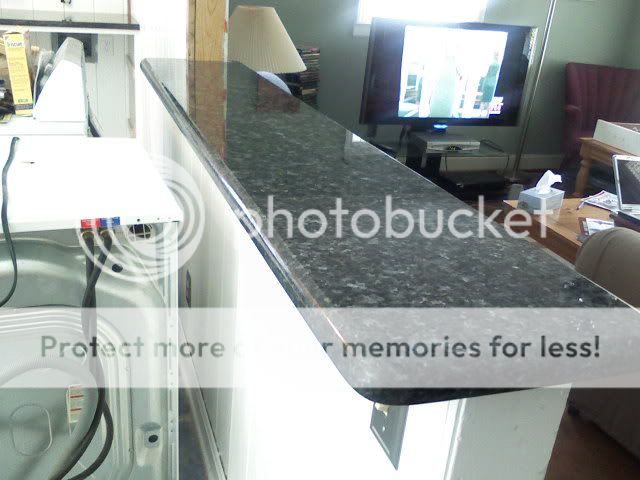

    I just measured ours end to end, and it is 13 inches. It works fine for us. Since the bartop is on an entryway to the kitchen, we were worried that if it were longer, we'd keep bumping into it.
    We use this area a lot, so it was great decision to put it in. This pic is just after it was installed.
    bartop
