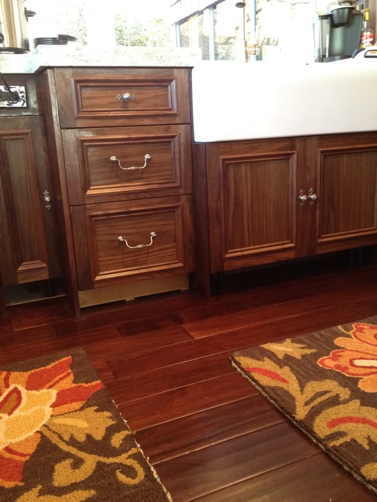

    I bought a display kitchen that had frameless cabinets. The doors are painted maple in a traditional style. Since my kitchen doesn't resememble the original display, I've used some Ikea bases and drawers with my doors/drawers to make this work for us. I'm also on an extremely tight budget, so Ikea is helping with the bottom line. We're still in progress and it's going very slowly, but I'll definitely post when we get some more cabinets installed. Hopefully by next week...
  • davidro1
    12 years ago
    great. another illustration of how to use Ikea components.
