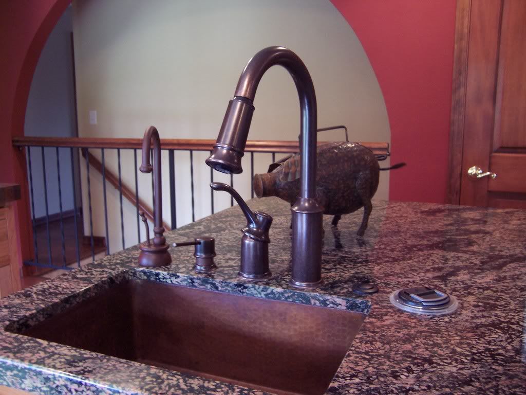

    Here is ours. It is a virtual forest of holes in the sink area countertop so it really doesn't show.

    Thanks everyone!!! Great pictures and input. I am now thinking that 3 plugs will be better. I do prep on the island. Claybabe your photos were very helpful as I will have the exact forest of holes and very similar quartz and faucet finish. Is your mockett the black or clear ring?
    RE: Mocket pictures?
    clear ring :)

    For those with Mocketts near the sink - how did you get those to pass code? I really love the idea and the fact that having Mockets would prevent cutting into my beauteous back splash, but everything I've read indicates electrical sockets cannot be that close to the water source (wet area).

    They have to be installed a minimum of 18" (I think) from the faucet/water source.
    Our Mocketts also have a slightly raised ring that would prevent water from getting into them.
    So far, in 4 years we've never had a problem with water getting into the Mocketts.
    I don't know how Claybabe's passed inspection...maybe the Codes are less stringent where Claybabe lives?
