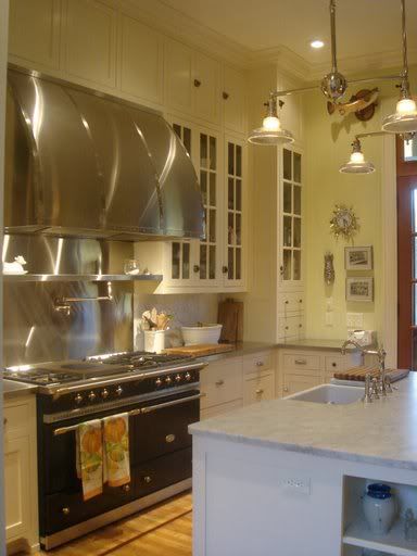

One way would be to make all the uppers with glass (either transparent or opaque) doors so that they store stuff but do not contribute to the "tall" look by extending the wood all the way to the ceiling.
An alternative is similar to PrettyKitty's kitchen (Fabulous btw), where the cabinets have similar color to the ceiling -- or the other way round -- so that eye is cheated into thinking that it is a part of ceiling and not cabinetry.
Hope this helps.
RE: How to make cabinets up to the ceiling look good - 10 ft ceil
The thing about very tall upper cabinets is that they tend to feel like they're looming. If you split the vertical area up, you get eliminate a lot of that walls pushing down on you thing. Breaking the door into two helps, with the shorter one on top. In both of the kitchens above, the door styles are different--that helps more. They also have glass on one rank of doors, which splits up the vertical plane more by pushing part of it back into the cabinet (view through the glass).

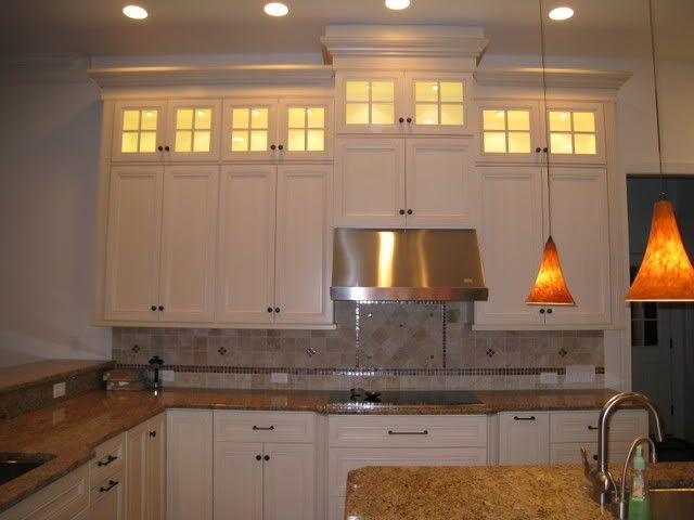

We have 11 foot ceilings and did stacked 18" glass fronted cabs on 42" uppers. We also staggered the heights for more interest.
The middle cab was missing the top part of the crown moulding trim in the above pic.
