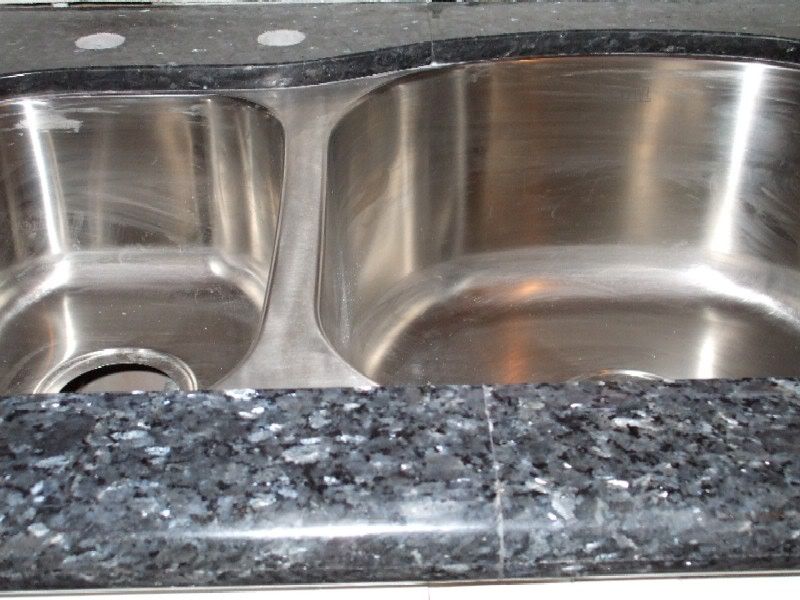

Hi larrylwill -
This is a great trick! Can you tell me, if you have granite such as mine, blue pearl, would you use a black pen - or should I use a dark blue? The fabricator is sending their "A Team" out tomorrow to try to make it better - but if that doesn't work I'm going to try the pens. TIA
RE: larrylwill -question about granite seam
Start with a black Sharpie which is water proof. Remember if you mark your counter and wait a few seconds, it will not come off so be careful.
Take the marker in one hand and 0000 steel wool in the other.
Look for an area that you can bridge black to black first.
Make a light mark bridging the black. Immediately start erasing it with the steel wool. If you do it fast it will lighten the mark and scatter it. You will get the idea as you start. The longer you let it dry before using the SW the darker it will be, so start quickly until you get a feel. If you scrub it immediately you can take it all off, but wait 15 seconds and its too late. You will see that you can take the black marker from black to light gray with a little scrubbing. It only takes a few seconds. You will be able to blend by how hard and the direction of the scrub.
After you do all you can with the black, try a dark blue one, same procedure. Maybe a light blue one. Remember the first time to start scrubbing immediately and you can remove it completely but wait 10 sec and you cant.
After you get it like you want you can protect it by buying some fiberglass resin from HD $15, mix a small amount and with a small brush apply over the seam. Its similar to what they use to a resin coat that comes on most granites now.
Post finished pictures. Don't be afraid and good luck.
