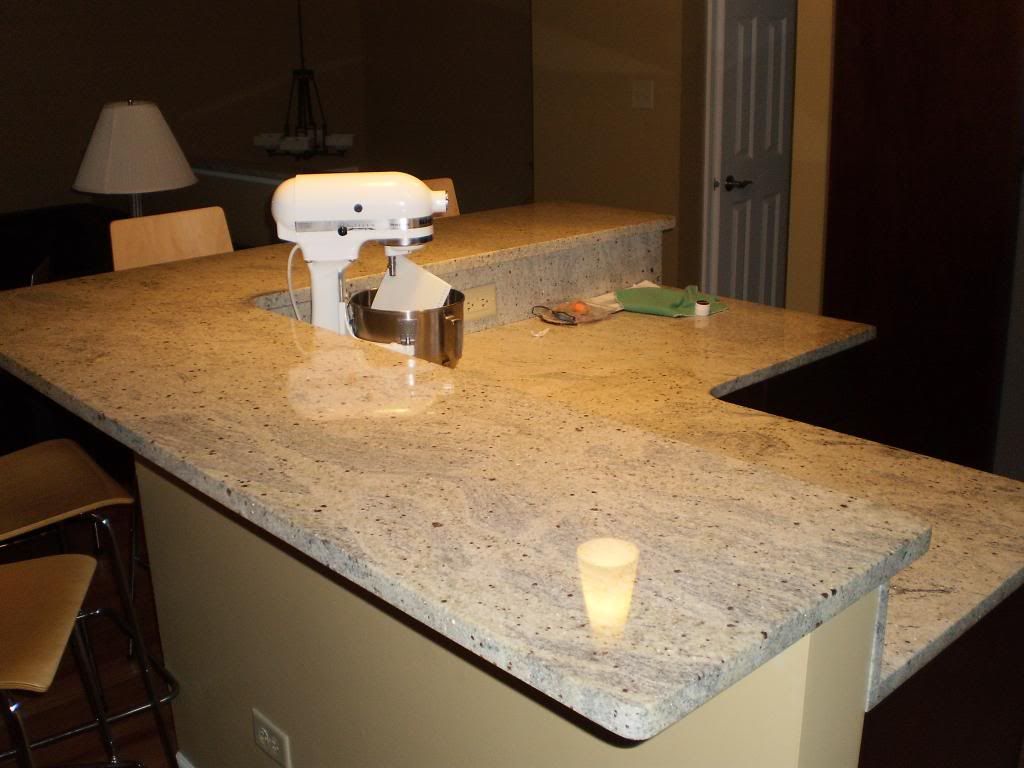

    We did something similar. We have a two level ''peninsula'' with the higher level, which is on the dining room side, in wood, and the lower counter level, kitchen side, is the same as our other counters which is soapstone. The top level is 19.5 '' with the over hang at ~13.5'', and the lower level is also only ~19.5''. The higher level is plenty of room for eating, but as our table is also right there, we pretty much use that area for our laptops.
    From kitchen side (right hand side of photo):
    From dining room side:
