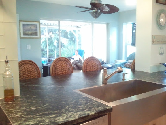

    We have ours with a flush counter install. The counter is a tiny bit above the sink, but really slight. Our cabinet installer just adjusted his cut of the base cabinet to allow for a flush install.

    Ours is completely flush. Your cabs HAVE to be perfectly square for this to work.
  • bcafe
    You know, ours is really flush. I was just feeling the area and I actually don't think it could get any better. The silicone seal around the sink is invisible so it is nice and tight.

    bcafe, that's how I want the sink to be installed! Beautiful! love it! Do you mean you cut the cabinet shorter so the sink can be the same height??
