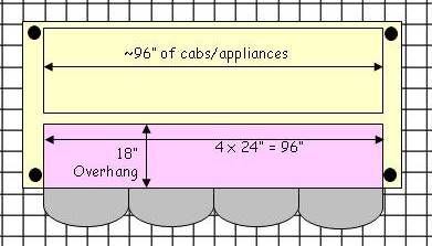

  • Buehl
    13 years ago
    Island/Peninsula Seating....
    Linear Seating Space:
    • Allow 24 linear inches per seat regardless of counter height
    Overhang:
    • Table-height seating (30" high): Minimum 18" overhang
    • Counter-height seating (36" high): Minimum 15" overhang
    • Bar-height seating (42" high): Minimum 12" overhang
    Corner Seating...if you have seats on adjacent sides, be careful that you don't overlap the leg room/overhang. Each seat needs its own leg room. So, if you have a 15" overhang on a side and a seat on the end, then the seat on the adjacent side starts 15" in from the end with the other seat so there's 15" of leg room for each. Like this:
    Is this what you're thinking of? If so, you should have more than enough room for 3 seats on the long side, but not enough for 4. However, I would encourage keeping that extra space for the long end b/c with legs it will not be as easy for people sitting at the outer seats to get into/out of the stools/chairs (legs get in the way) so that extra room is a real help!
  • Buehl
    13 years ago
    I meant to put "the numbers" in...
    107" wide island
    -72" for 3 seats
    35"...which is enough for 4 seats IF you don't have a seat on an adjacent end AND IF the legs + overhang over legs do not take up more than 5.5" each (maybe 4" legs + 1.5" overhang on end?)
    One thing...4 seats straight across is not conducive to conversation...everyone will be sitting "like ducks in a row" (sort of like a shooting gallery!). With at least one seat around the corner, it's nicer for conversation.
  • allnewappliances
    13 years ago
    Thanks Buehl! Each leg is 4 inches and the overhang on one side is 18 inch and the other side is 15 inches.....it looks like there is room for 4 stools, but you are right that it's not the best for conversation. I just didn't want to put the overhang on 2 sides if we only put stools on the one side.....
    Thank you so much for drawing this out, can see it so much better :-)
