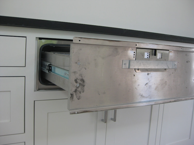

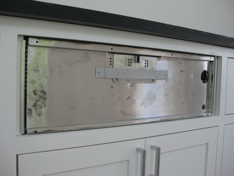

I have an inset cabinet with a warming drawer. Here it is before the panel was put on:
From Menlo Farmhouse

sorry archnista - but as you can see you are just flat out wrong!
Warming drawers that accept panels can be used in framed inset cabinetry. You simple need to plan out the construction, and ACTUALLY increasing the depth of the warming drawer or all cabinets is almost always the first step.
As you can see from MP's pics you'll need to account that most warmer drawers are around 10" tall and a std. drawer is 4-6" so consideration needs to be given to the overall look of the elevation that the WD is going into.
