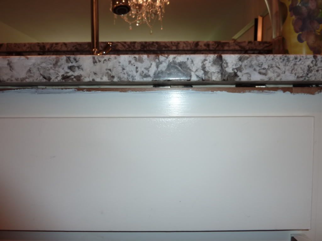

Finally got our granite installed, yay!!!
Overall i think it went okay. There were little problems here and there such as...our cabinets apparently were not leveled so now the granite does not sit right on top of the cabinet. Here is a picture:
If you look closely the gap is between the brown (original paint of cabinet and we painted it white) and the granite. You can see the white parts which are the caulking. Fab did ask us to get moulding to add support to the granite otherwise granite can break if too much pressure.
What do you experts think?
RE: Gap between granite and cabinets
Hmmm... definitely need to do something there. Moulding is a good option. Do you have a far-away picture? How bad does it look from a distance?
From far you cant see it at all:
I know cabinets not leveling is common, thats what we call builder quality eh!?! Anyways, was just wondering what people do to fix the issue. The fact that we are recommended to put in moulding to support after the installation, is it common?
I think I can count the times we had perfectly level cabinets on an install on one finger. No serious - more often than not there are gaps between the stone and the cabinets, and your gaps are very small, compared to some I have seen. The fact that you have the contrast between the original color and the paint makes it a lot harder to look at.
The suggestion of adding molding is a great (and often made!) one and you would be surprised at the difference it will make. It is not up to the stone guy to do the molding - it is the GC or home owner's responsibility. The stone guy just needs to ensure that the stone is installed and supported (most often shims will be used in the low spots)
Your stone looks gorgeous!

The moulding will not support the weight of the granite. You need to add shims in the gaps between the cabinet and the countertop. Once it is properly shimmed, then add moulding to cover the gap.

It looks like it IS shimmed, but it's hard to be sure from here. Do find out for certain, then finish painting! I'm not sure you'll even need trim to make it look good once painted--and probably nothing much bigger than a pencil.

Hello fori, if shim is a piece of wood than there is no shim in there, there is a lot of caulking which you can see in the picture as the random spots that are connected from the granite to the cabinet.

here is a better picture with flash, you can see the white spots (caulking) that goes from the granite to the cabinets:

A shim is a small piece of wood (here) inserted between the top of the counter and the stone to help level out the unevenness of the cabinets. Usually this would be put down before/during the granite install to provide the support needed. Apparently this guy didn't do it, which seems pretty dumb to me.
The trim moulding you would then use would be applied to the cabinet up tight against the stone in order to cover the bit you didn't paint as well as the shims and glue that you would see. The trim moulding would be attached with small nails (a brad nailer will do it). It would not be weight-bearing.

That looks like the front edge of your sink? If so, it's probably a good idea to shim as the granite will be weak in that area.
Looks like it might actually be a perfect fit for the free paint stirring sticks they give out at HD. Might want to swing by and grab a few and see if you can squeeze them in there. If they fit then you can just cut them down to size.
Another option is to buy wood veneer at a wood hobby shop like Rockler. Just glue up as many pieces as you need to get the right thickness, or they generally have thin small pieces of "craft wood" you can buy and use too.

You can buy packs of shims at HD or hardware stores, often in the door section. they're wedge shaped so you stuff them in as far as they go and knock off the extra (being careful not to hit the counter of course!).
Shims can be made of wood (cheap) or plastic (not so cheap). Free paint stirring sticks are a good suggestion IF they match the gap you have. Depending on the configuration of your cabinets, sometimes strips of lunber or plywood can be glued & screwed to the inside of the cabinet front and positioned to support the granite. This solution is much easier when done before the granite is installed. I thought fabricators/installers were supposed to check the cabinets for level before installation of the counter tops.

anyways, i like the idea of glueing lumber strips to the inside front of the cabinet. maybe that along with the molding, we can add good enough support for the granite?
